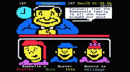

Very cool! Now recreate Bamboozle on Channel 4! 😅
Sounds like fun, was that a Teletext puzzle/game? I've been thinking about how Teletext could be represented on home computers of the era. Obviously, the BBC micro could do it, because it had a Teletext mode. The Oric-1 is close, because its text mode is closely based on Teletext. Other early 80's computers struggle, because they either can't mix 8 foreground / background colours freely (C64/VIC-20); or don't have a high enough resolution in a mode that does. The Acorn Electron & Amstrad CPC464 could simulate it in their 8 colour/16-colour x 160 pixels per scan mode, but flashing would have to be done in software. Oddly enough, the ZX Spectrum, despite its 32 colour bytes/line could do a fairly reasonable job, because every new colour change occupies a blank space, so the colour resolution in Teletext is lower than the character resolution.
