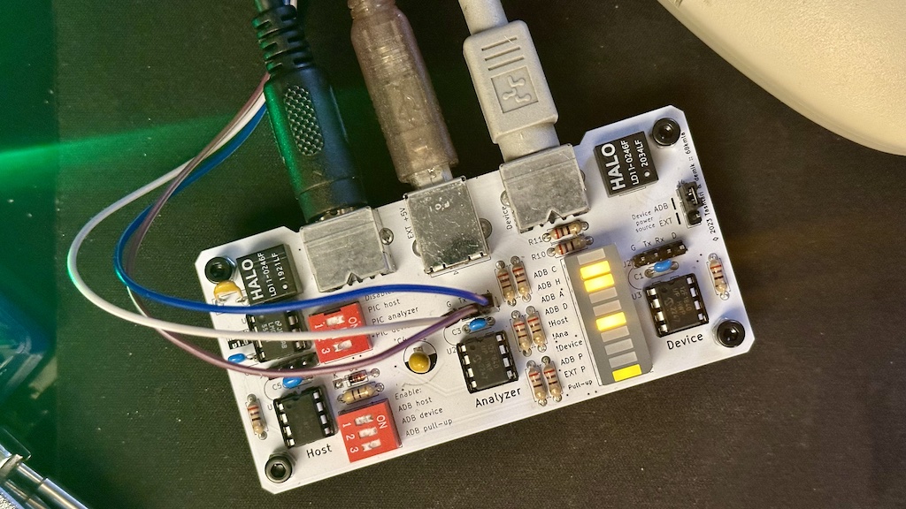

Introducing ADBDB.
ADBDB is a Developer/Debug Board based on @tashtari work.
It was created because working on a beadwork work until you start fixing more the breadboard than doing actual work.
It's a small PCB (10x5 cm) hosting all three tools (test-host, test-device, adb-analyser) with a few features:
- use external power for onboard electronics (using USB type B connector)
- has signal filtering (it's using the ADB filters from a Macintosh SE)
- external ADB device can be powered by either the Mac or external power
- on demand ADB 470Ω data line pull-up
- 200 mA PPTC resettable fuse to protect the Mac ADB port from overcurrent
- each tool can be enabled or disabled using dip switches
- each end (mac or device) can be enabled or disabled using dip switches
- a few debug LEDs (power, activity, modes…)
- had UART headers for every one of the tools + the ADB data line so you can plug a scope for example
The build is all through-hole and only uses available components.
One common use is to sniff the traffic between a Mac and a device. In this example quadra booting with a mouse attached:

The prototype board has been tested on a Quadra 650 and a Quack and is working fine. There are silkscreen issues on the prototype version (v1.0) which are fixed on the released versions (v1.1)
Gerbers and schematics are going to be published this week-end. Thanks @tashtari for the assistance :)
