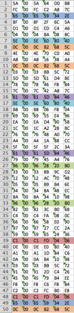

Interesting. I might have to slap the analyzer on mine to see if the host sends it something that seeds the value or something...
I was thinking it could produce a sequence of rolling codes, but I took more readings and found repeats. They don't appear to be in a pattern though, maybe it just chooses from a list of valid codes and the software is set to expect a different one each launch?
