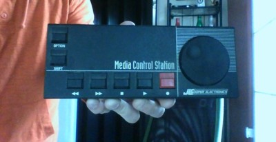

Things like these exist.
Ooh. That's neat. What are they used for, do you need special software to interface with them?

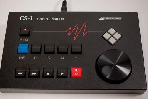

They're great. The CS-1 was common in recording studios for audio and midi editing, but they also work with Adobe Premiere and probably other video editing software.
I have a copy of the software, but it works straight with some software. I'll backup my disk if it isn't on mac garden.

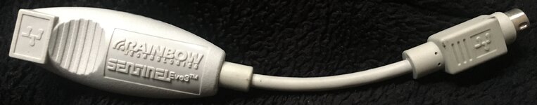

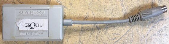

Echoing @Phipli, creating a way to image these would be nice if one doesn't already exist. Whatever software/hardware replacement can be made will probably still need program-specific (serial specific?) ROMs. Here are two versions I have and would be happy to poke at:
The casing on both units can probably be split open but may crack some plastics. If it's necessary I'll give it a try.

The QuarkXPress 4 dongle I ordered looks very similar to the second picture you linked, my hope is that I can get a capture of the bus activity when QuarkXPress 4 starts and figure out from there what's going on. If it's cryptographic, who knows, but if it's just spitting out a serial number of some kind, there's some hope...
