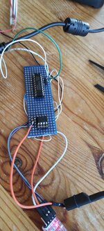

Hai tashtari! I'm bringing the discussion here since from the AirTalk thread for the internal PB 1xx modem to LT adapter.
As you can see from the photo, I implemented a high-tech adapter board. It is basically just a 741 buffer that disables the mac tx when CTS is high.

Well turns out it is my fault, I completely overlooked CTS from the pic.... So I grabbed a proper usb adapter with CTS, plugged it in and... it works! :O

It is *very* slow but maybe I just misremember how slow localtalk really was :) Probably my circuir + the usb adapter is not playing super well. Also tashtalkd refused to do sendto() on OSX so I had to run it into a linux VM, and that surely added some latency to everything. Debugging that is for another day.
I think it is promising in any case, since I want to really use it with @cheesestraws AirTalk, so the next step is the ESP, but I imagine it should work there too.
