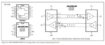

How come you don't use the MAX488? It has RxD+, RxD-, TxD+ and TxD-?
I suppose because I didn't feel like it should be necessary given that LocalTalk is just one differential pair instead of two. Of course, as long as the transceiver has an active-low receiver enable and an active-high driver enable, this should work fine too.
...And because I have an irrational love of 8-pin DIPs, that too. =)
They are 8 pin dips :)
It's the active-low receiver enable and active-high driver enable that are missing I guess.
Oops, I was looking at the wrong chip. Hmm. I thought a driver enable would be necessary given that LT is a shared bus, but because it has transformers at every node, I suppose you could use a MAX488 with the 1.x firmware (since it has a separate input and output line)? Or I could produce a version of the firmware that didn't have a driver enable output at all, just an input and output line... I don't know. Is there an advantage to that?
Oh, I'm starting from a position of ignorance - the question was "forgive my stupidity, but I see the 488 has two pairs and you're using two single pair chips, what drove this choice?" Rather than "you should be using a 488". :)
I've been using some MAX488s but for a single device, rather than something working as a bus.
Ohh, I see. I was using two SN65HVD08s (single-pair chip with driver/receiver enable) in my early prototypes, but the TashTalk hat only uses one, with the TxD and RxD pins shorted together, and it works fine.
