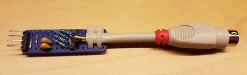

- Original Apple LocalTalk or Farallon PhoneNet adapters are a) difficult to obtain and b) way overpriced. So I startetd experimenting with "CapNet" adapers as well (https://www.jagshouse.com/localtalk.html). These can easily be DIY and are very cheap, just 4 resitors and 2 caps and even work in conjunction with PhoneNet adapters. I have two Powerbooks G3 and a TashTalk hat happily talking to each other with different permutations of PhoneNet and CapNet adapters. I do, however, strongly recommend against using CapNet adapters to connect computers in different buildings with possibly different mains. Personally, I do not trust these CapNet adapters too much with regard to galvanic isolation. If you plan to connect computers supplied by different mains do yourself a favor and use original Apple LocalTalk or Farallon PhoneNet adapters, these are designed for that.
Here's a pic of one of my CapNet adapters.

Welcome to the forums, and nice work. Good to hear more empirical stuff about which transceivers work.
That's a very neat build!
