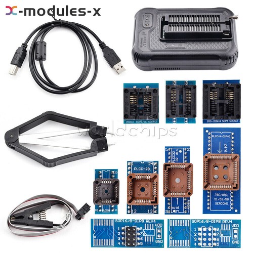

Turns out I ordered a Pic 150k. Didn’t look too closely and it was $10 with next day delivery so didn’t think twice. Oh well, might be handy some other time. The cheapest TL886 variants seems to run about $85 😮
On eBay there are options like this :
There are likely cheaper options if you buy from AliExpress. Such as this, the first example I found (not researched) :
