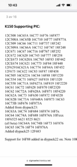

Just recieved my programmer and am ready to dump some roms. Problem is I have no clue which chip/pic type to choose? 😅. Anyone know what type from the list should work for this rom? Thanks

It's a 27C128 28-Pin DIP EEROM. In your programmer you should be able to choose a vendor and part number/type. It doesn't look like you're looking in the right place. The part you want is not on that list - that is a list of PIC chips (Microchip microcontrollers). Also, I guess there are DIP PIC chips, but they are usually PLCCs or maybe J-bend devices (at least the ones I have used in the past). Anyway, not the droids you're looking for.
Thanks. That explains it, I have the completely wrong tool. Back to shopping 😅
What did you buy?
You want a TL866 probably.
Turns out I ordered a Pic 150k. Didn’t look too closely and it was $10 with next day delivery so didn’t think twice. Oh well, might be handy some other time. The cheapest TL886 variants seems to run about $85 😮
