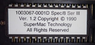

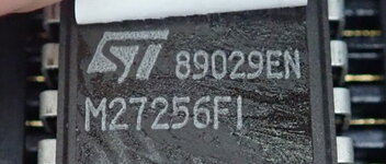

SuperMac-Spectrum-8-Series-III-v1.2-ROM-Label.jpgSuperMac-Spectrum-8-Series-III-v1.2-EPROM-ST-M27256.jpg
This Spectrum 8 Series III EPROM is a ST M27256.

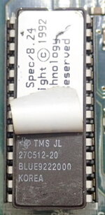

This Spectrum 8*24 PDQ EPROM is a TMS 27C512. 200 ns? I obtained this card from Italy from @mgmac a couple of months ago. It works well! Thanks again.

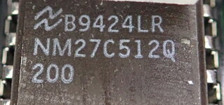

This Spectrum V uses a NM27C512Q 200 ns EPROM.
Upon reading it, some of the text in the EPROM contents looked corrupted. Indeed, always click verify after a read! The EPROM was not reading consistently and verify at least will tell you if it read the same twice in a row. The pins had significant oxidation/tarnish. I used Deoxit, a pencil eraser, and final a scalpel to get a consistent read from the EPROM. As described earlier, I burned a copy and installed it in the Spectrum IV successfully. So, I believe this ROM image is valid.

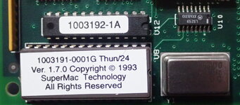

This SuperMac Thunder 24 does not have a pullup on LS259.
This SuperMac Thunder 24 uses an AMD AM27C512 at 150 ns.

But this Thunder 24 card does have a pullup on U10.
Back to using a 200 ns EPROM. In this case, the NM27C512.
I have four SuperMac video cards with U10 using an LS259. I believe that is a 74LS259 8-bit addressable latch.
A 10 kilohm (brown, black, orange bands) resistor across pin 16 (Vcc) and pin 4 (Q0 output) would seem to provide a pullup to one of the outputs when the chip is not enabled. It will be overridden with the actual output signal (high or low) when the chip is enabled. I have no idea why this was needed, and why it was only needed on one output pin. Two of my cards have the resistor (V and Thunder with v3 ROMs), two do not (IV and Thunder without v3 ROMs). Was this a fix that SuperMac added to cards sent in the receive the upgrade?

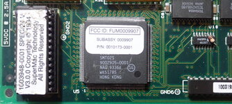

The card does not look like a SuperMac Thunder. Instead, it is identical to the Spectrum 24 Series IV and V boards.
The Spectrum 24 IV uses a 30.240 MHz crystal. The V and Thunder Light use a 40.000 MHz crystal.
However, unlike my Spectrum 24 boards, the Thunder Light has C5 (1 µF), R33 (100 Ω) and R33 (100 kΩ) populated.
Maybe if you have a Spectrum 24 Series IV card, you could swap out the crystal, add the three passive components, and swap in the Thunder Light ROM to get a Thunder Light card?

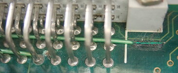

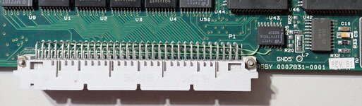

I just obtained a SuperMac Spectrum 24 PDQ Plus. It is physically different from the shorter Spectrum 8 24 PDQ pictured beneath it.
The board is revision B1, which must stand for "Bodge" as it has a pair of wires near the NuBus connector.

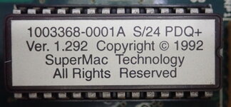

The PDQ+ has ROM revision 1.292
On a TMS 27C512-20JL EPROM.
The ROM file is attached.

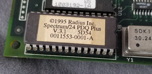

There is a v3.1 ROM file floating around in a folder labeled Spectrum 24 PDQ (no plus). Inside the folder, the read me and the file contents indicate it is actually a Spectrum 24 PDQ+ (yes plus) v3.1 ROM. This is from Daniele Gratteri. I have attached a copy to this thread.
Burning a EPROM and putting it into my PDQ+ confirms that it works.

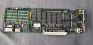

Sometimes eBay taketh away, sometimes eBay giveth. A battery-bombed Quadra 650 held a fully working unicorn -- a Radius Thunder IV GX 1600 with DSP card.
The EEPROM (not EPROM) is labeled v1.2 but was already upgraded to v1.2.3 by the RadiusWare Mr. Flash updater.
I am including obnoxiously large images of the fronts and backs of both boards, as the DSP board is Rev B and I've only seen Rev A images online.

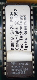

SuperMac Spectrum 24 PDQ+ v1.60 (For archive purposes. A better version, 3.1, is available.)
All three were on the same type of TMS 27C512-2 EPROM.
SuperMac-Spectrum-8-24-EPROM-V1.6-27C512-2.jpgSuperMac-Spectrum-8-SI-EPROM-V1.0-27C512-2.jpgSuperMac-Spectrum-24-PDQ+-EPROM-V1.6-27C512-2.jpg

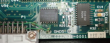

The PDQ+ was a newer revision (D1, as opposed to my earlier posting for B1). Yet, it has the same bodge wires to U43 as did the earlier revision.
