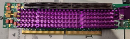

I had some extra hours at hand so I thought I'm doing something good to my PM6100 and replace its Sonnet Crescendo 250/256k for a 400/1M I recently 'found' on ePay.

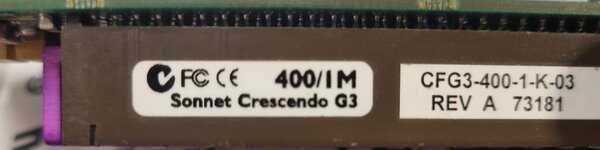

Well, no dice 😢... the extension loads but is crossed-out, i.e. did not find anything... or it's the wrong version of extension. I'm currently using version 2.3.1 which works fine with the 250/256k which is a "REV E".
The 400/1M is a REV A which doesn't have the usual XILINX PLCC CPLD to the left of the heatsink. Searching Google for this Rev, it seems it's pretty rare/uncommon.
Given it seems to be a much earlier revision than the usual "D", maybe it needs to be used with an older extension? (V1.4.x)
Before I try them all one by one I thought I'd ask you, the nice bunch of 68kmla if somebody already had this behavior before and/or knows if a special version of the extension is required.

Driver should work, scrub those contacts with an eraser, and then spray with contact cleaner and try again. Also power off the computer and give the PDS slot a good soak with contact cleaner and let it evaporate and try again. I'd bet money you bring it back to life, I can see the dirty contacts in your photos even.
Did so in the meantime. Cleaned with Isoprop, scrubbed with glas-pen... they shine like new now.
PDS slot got a nice contact cleaner spaying... still nothing.

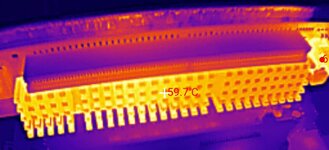

So is the 400/1M a dud? Well let's see what the Tricorder says while the system is hanging with the 400/1M...
40°C (104°F) is not incredible hot, but it does get some juice.
The inductors in the back... the bottom one is definitely warmer (~ same 104°F) than the one above it (darker), while the 4410 SOP Mosfets are even 5° warmer.
So it seems to be "online" but nobody turned on the ignition yet.

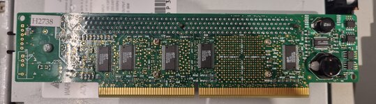

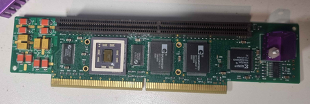

Ah, for those interested... this is how the REV A looks "underneath the skirt" - using a QFP CPLD is even more advanced as the later PLCC ones.
Maybe the card is defective, but I have a hard time believing its the driver, I've sold and owned numerous sonnet cards and I always use the latest driver no matter the system. Never had an issue, Sonnet is really good about backward compatibility with their drivers. Some of the other brands not so much. I just went through my photos and found Rev A, B, C, D, and even F on some that I have owned. Maybe you'll be lucky and find that an older driver is the ticket but I don't know how sure I am about that.

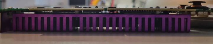

My Crescendo is warped. Just slightly, but it's doing the "banana". Looking veeeery closely, you can see the PCB bends up a tiny bit in the middle:
This will result in the card not sitting totally straight in the PM6100 slot and thus some pins don't have steady contact.
It is also viewable at the distance-holders of the loop-through AV slot of the card. Left and right sides are flush to the PCB:
...while the middle one has nearly 1mm distance to the PCB (nope, it's not a shadow):

The overly tight heatsinks on Sonnet cards often lead to warping of the cards. Whenever feasible, I take them off, especially on the G4 tower upgrade cards since the Apple heatsinks are often better, if not at least sufficient (and the little fan Sonnet puts on theirs is typically kind of loud).
However, on this type of card, you don't have that luxury. You can probably get away with slightly shimming the standoffs between the heatsink and card. You don't need much, just a fraction of a mm, but enough to allow the card to relax without losing contact with the CPU.
