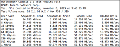

Here are some QB 4.0 results from a SiL3112 card with the EEPROM replaced & flashed, and with the voltage regulator changed - all in order to work in a Quicksilver. [Specs: 1.5 GB RAM, SiL3112, Netac 256 GB SSD and a 1GHz Sonnet ST CPU.] ¡Ay, caramba!

Here are some initial disk benchmarks in the G4 Quicksilver. There are still several more disks and interfaces to be tested though, plus I hope to get the SCSI interface benchmarked too.
Here's the original hard disk, Seagate Barracuda ATA IV 60GB ST360021A IDE 7200rpm:
Here's an IDE-to-SD adapter, paired with a class 10 SD card, and connected to the primary IDE channel:
Here's an IDE-to-SATA adapter paired with a 750GB Crucial SSD, and connected to the primary IDE channel:
My analysis: The hard disk and the SD card are roughly equal for sequential reads. The SD card is substantially better for small random reads, but the SD write performance ranges from bad to terrible, whether for sequential or random writes. Given a choice between these two options, I'm not sure which one I would pick. Do you prioritize small random reads over write performance?
But it doesn't matter because the IDE-to-SATA SSD completely outperforms the first two drives in every category. It's not even close. For large reads where the other drives are at their best, the IDE-to-SATA SSD is still more than twice as fast. And for smaller transfer sizes and random reads/writes it can be 10x faster or more. Wow!

Yes @bigmessowires’ 750GB Crucial SSD sorta smokes my 128 GB Inland SSD + "Bribge" adapter in a similar Quicksilver running Mac OS 9.2.2 with QuickBench 2.0. (QB 2.0 and 4.0 do differ a little in reporting and then there’s also the difference between testing OS 9 and OS X.)
Too bad QuickBench 2.0 doesn’t provide those Standard Averages at the bottom like 4.0 does.
But still indicative of the relatively low cost & performance advantages of SSDs.
My SSD is the Crucial (Micron) MX300 750GB, which I bought in 2016 and later removed from another computer. I wouldn't say it smokes the 128 GB SSD - the only place where they differ significantly is for small writes, otherwise the numbers are pretty comparable. I wonder if the difference in small write performance is actually the SSD, or if it's the SATA adapter, or OS 9. Are you able to boot into OS X and test it again?
