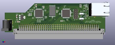

I see that you have betas on the way, do you consider the GitHub schematics "final"? As mentioned, I'm considering a much smaller form factor that could fit with a IIsiFPGA on a custom dual-PDS adapter (or stand-alone!). Current WiP looks like this:
The 5V plug on the left is to power up the board for JTAG (standard 2x6 headers) programming. I still need to double-check some mechanical measurements to make sure both the 5V and the large Ethernet plug (integrated transformers...) won't cause issue on an hypothetical dual-PDS adapter and/or standalone.
I'm also using a 25 MHz oscillator instead of a crystal, and mechanical switches for the slot selection.

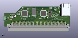

Nice - I am interested in a small form factor with an onboard RJ-45 socket as I currently run my SE/30 board outside its case.
Is your modified design just for a IIsi?
It should be compatible with the SE/30 and maybe the IIfx as well (the CPU clock is not used, it's on a different pin on the IIfx), as most of the critical signals are the same between those 3. The goal is also for it to be firmware- and software- compatible with @halkyardo 's design, by using the same chips and the same pins for all the critical stuff. So it should be compatible with the same list of machines.

Turns out, space is really constrained - that 5V plug wouldn't fit, and I'm not sure an ethernet would would on the other side... so as not much power is needed, go for a micro-usb instead of the bulky plug, and rotate the Ethernet 90° so the cable has space inside the machine.
