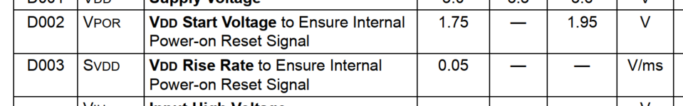

Datasheet says if voltage drops below Vpor, a power on reset would be generated. So you could use two transistors to push-pull the vdd input either to vdd or ground (via a low ohm resistor) to discharge the bypass capacitor quickly. Some math give how long that takes.
cards and drivers for mac II/se says this for timing.
A bit hacky but should be cheap to implement.
If you have pins on the glue logic that could be cleaner, as stateful logic isn't a new thing as you said. Though having to count multiple writes would rapidly expand number of IOs required.
