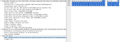

Just managed to send my first packet down the wire by poking at it through MacsBug, which was immensely satisfying. Now to go insane staring at Inside Macintosh until I can get my driver to work 🤓

Congrats! That's so cool to see the packet, what a great feeling. I want to say I really appreciate all the documentation and explanations you've put in your source code. For someone with only software knowledge, it's been quite enlightening.
Congratulations! That's a huge result!
It has an software-configurable clock output that defaults to 4MHz, but when set to 25MHz
I hadn't realized CLKOUT defaulted to 4 MHz. That means your timings must 'work' (even slowly) at 4 MHz so that the CPU can reprogram COCON to generate the 25 MHz clock, I suppose? Annoying chicken-and-egg problem :-)
