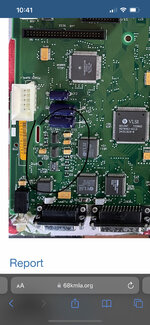

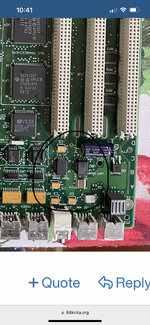

All right so I finally2024-01-12 11.28.23.jpg2024-01-12 11.28.41.jpg had to time to get to my board this morning. I removed 4 Ta caps that I had installed earlier, the ones neat the VIA and SWIN chips. Alas, everything looks clean, and all the traces show continuity. I will repopulate, but thought I'd send you the pics of the board areas where the caps were after removal
Ha yeah thanks, I had noticed this guy too who looked a bit crooked. It tests OK though.
