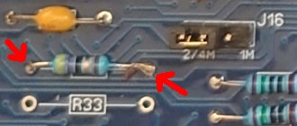

@Kai Robinson Alright, I think I have another thought looking at the board photos in detail.  I noticed R33A, yes a 47 ohm impedance-matching resistor on a RAM CAS line, might have a soldering quality issue.
Ooh, good catch, i'll check that.
