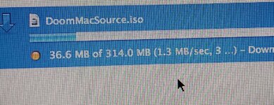

This is my 400MHz G3 Pismo, using an 802.11g WiFi card in the CardBus slot, from the CyberDuck FTP client in 10.4 :
Since I took the photo, it has increased to 1.4MB/s stable which is about 11Mbit/s. This aligns with 802.11b speeds, I'm not sure how to tell if it's working in that mode.
Edit : Connection was 802.11g (54Mbit).
I plugged in the (100baseT) ethernet. I got a peak of 3.2MB/s, in CyberDuck, with the interface traffic showing as about 4.3MB/s peak, so about 35Mbit/s.
CPU usage was high, but not saturated.
And testing downloading from Mac Garden (Same 400MHz G3 Pismo, 100baseT) peaks at 1.2MB/s and completely saturates the CPU.
So in my instance, even with only 100baseT, the CPU is likely the bottleneck.

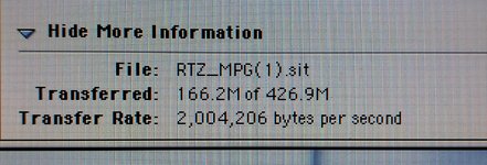

Another Last quick test - I rebooted in 9.2.2.
Using the FTP client Transmit to download a file from an FTP server on my phone with the Pismo using ethernet, it peaked at just above 2MB/s (photo shows just under 2MB/s).
Edit : other FTP transfers have broken 3MB/s. Not sure why the first was slower.
