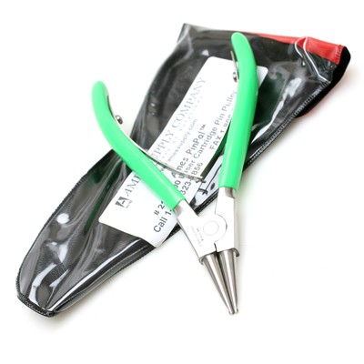

Got me that tool that allows you to open the cartridge. Only $5 :)
Hopefully it will be easier to open the cartridge.

Does anyone know a current source for those Ames pin pullers? I couldn't find one. Inspired from a great tutorial video about these cartridges I went thru my jar of screws and found one that worked pretty well and I was able to pull the tabs out without damage.
