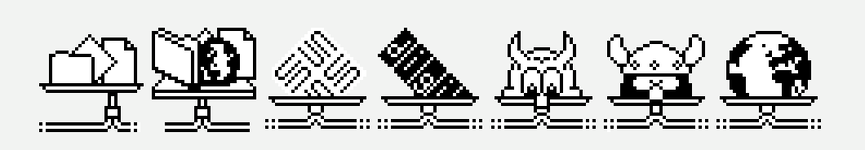

I can address both of these. The volume name has an easy solution: Put a "volume name = My Volume" line in the volume definition to get case sensitive volume names. The netatalk 4.2.0 release notes talks about the reason for this change.
Regarding the volume icon: In previous versions, the netatalk source code contained a byte for byte copy of Apple's original ICON resource that you see when mounting an AppleShare volume. I replaced that with the redrawn ICON that you see now, to remove proprietary copyrighted data from the open source package. Thank you for your understanding. :)

The change in Netatalk v4 is that I removed the two leftmost icons from icon.h, and added these two that I drew. The top one is the new default, and the bottom can be activated with "legacy icon = sdcard".
The rest of the icons are still available in Netatalk v4, but rather than attempting to detect the OS of the host system, can now be freely selected with the legacy icon option with "sunlogo", "declogo", "daemon", "hagar", and "globe", respectively.

I had the same thought at first! Unfortunately if you don't pass an icon to the AFP client you get exactly that: A volume without an icon. Just the volume name text on the desktop. What was Apple thinking. :D
For a while I played around with the idea of having netatalk read a user supplied bitmap file from the file system and use that for the icon. But I got lost in the intricacies of reading, decoding and interpreting arbitrary bitmap data in C. If you want a small coding project for yourself I happily accept contributions. ;)
That jibes with what I see under Mac OS 8.6 but not 7.5, there I see the "leftmost" icon, not your new icon. Could this be because my 7.5 machine is doing AFP over AppleTalk and the 8.6 one is doing AFP over TCP/IP?
I have observed that certain AppleShare Client versions ignore the server supplied icon and always uses the default one from the client’s resource fork. Haven’t mapped out exactly which ones behave like this though.
