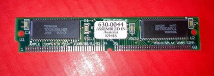

My next victim is a Macintosh LCII logic board. The seller said it played chimes of death at power-up, possibly due to missing VRAM, and needed to be recapped. The board looks pretty clean, so I was surprised when during recapping I nudged one of the ICs and it fell off the motherboard (see the circled chip in the photo). I cleaned up the pad and resoldered the chip, and finished recapping. I added a VRAM SIMM stolen from a 475, and I'm using a working power supply from that same 475. It does not have any RAM besides what's soldered on the motherboard.
When powered-on, this LCII shows a solid gray screen and plays chimes of death after a few seconds. There is no startup chime - it goes directly to chimes of death. After the ascending death chime, there's a second chime of four more notes - is this an error code? I haven't encountered this before.
I'm thinking maybe the RAM is bad? Or the VRAM SIMM that I stole from the 475 isn't compatible?

I may be misremembering, but I don't think missing VRAM on these causes a death chime, I think it just sits there not displaying anything in a deeply annoying fashion. So it is probably something else.

There's something wrong with the video though - black vertical lines through the picture. I tried two different VRAM SIMMs with the same result.
But when there's other stuff on the screen, or you drag a window around, the black lines begin to shimmer or even disappear from some areas of the screen.
So there's probably a data line at the VRAM socket that's flakey - at least that's my guess. If you look carefully, there are actually a few places where the black lines become white lines, like in the letter t in "Disk First Aid". Maybe two of the VRAM data lines are bridged.
The lines repeat every 16 pixels on the 12th pixel (0-based). And it's a 16-bit data path, so that makes sense. It might be one of the data bus contacts or connections between VRAM and the CPU, or the other set between VRAM and the CLUT DAC. I will beep them out.

I found and fixed a broken trace going to the CLUT DAC, and now this LCII is ready for... whatever one does with a 30-year-old computer. This was after I spent 15 minutes troubleshooting lack of video due to not having any VRAM installed, oof. I can't switch out of B&W mode at the moment, because there's no Monitors control panel on the only disk I have handy with the required system enabler extension, but the video works.
