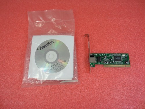

Searching for a compatible networking card for the Power Mac 6500/300 I recently bought at VCF Southwest. Great bridge Mac but no networking. Apple Slot II cards start at $100 and are made with the RTL8139 chip. What I've read online indicates that any PCI networking card made with this chip is compatible and their starting price can be as low as $10. So if I were to buy this card, is it compatible with the included PowerMac drivers? I don't want to buy anything that's physically compatible but Apple's software won't recognize.
If you know of specific 3-party networking cards that are compatible, please let me know.

This should work in any Mac with a PCI slot:
(I have one I've used in a 6500)
Mac drivers here (I don't believe any of the Apple distributed Ethernet drivers (extensions) support this Ethernet chipset):
993v14.sit.hqx which is include in the #1 download.
If you want to use the 2 6500 PCI slots for other cards (display/video cards, USB, Firewire, etc) a cheaper alternative to a Apple Comm Slot II Ethernet card is this recreation:
There are CSII cards with the Digital 21040 chip as well. I've got one, but no longer have anything to install it in.
It appears that these work in the 6500 - https://discuss.haiku-os.org/t/power-mac-6500-audio-in-beos/12481 (the problem there is no sound in BeOS, but the CSII card's ethernet worked fine)
...but here it looks like pizzigri was having issues getting them to work with MacOS 8.6 -https://68kmla.org/bb/index.php?threads/apple-ethernet-csii-card-no-boot-in-a-6500-board.43802/ (there was no response or update, so a bit inconclusive on the outcome)
The RTL8139 PCI card does require drivers, it doesn’t work with built in. The CS II with digital 21040 works without drivers but is 10 megabit only. Not that you’ll get anywhere near 100 Mb/s with OpenTransport anyway.
Read the bizarre caveats to the CS II recreations before purchasing one. Think what other similar decisions may have gone into the design of those cards.
