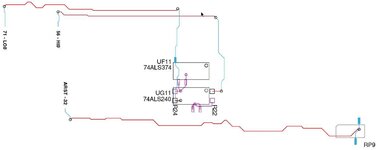

I've reconstructed the traces/chips/pads for the three signals that meander down off NUCHIP in the NuBus section of the Bomarc Schematic.
Trying to figure out where ARST, LO0 and HI0 go and what they are doing?
Some of the circuit seems like it can be recreated on the NuBus Adapter side of the PDS?
Red = Solder Side Traces
Blue = Component Side Traces
WTF.jpgStrange:
HI0 and LO0 are jumbled into multiple pins on one side or the other of resistors on the solder side?
ARST is connected to a pair of pins on a resistor pack?
How much deeper do you think I need to dive into this?
Next step would seem to be scouring the remainder of the pages for the ICs to see what might be up?
ARST is probably an asynchronous reset.
HI0 and LO0 are probably clocks. In the IIcx schematics (bomarc) page 4, two crystals (Y2, Y3) are fed into UG11, with multiple drivers in parallel, presumably because clocks have large fan-outs (lots of users) and are long-distance.
IT seems to me UF11 does some divide-by-2 from LO0 (~32 MHz from Y2) to produce the ~16 MHz clock for the system. HI0 is 40 MHz from Y3.
Thanks, do my AI doodles help, not so good with words.

ARST remains a mystery then? I'll fan out the traces from RP9 to see where thy lead with annotations on any ICs involved.

LO0 would seem be generated in UG11 and UF11 it would seem? I guess it would be my next step to doink in all inputs and outputs from that mess to see if their innards lead anywhere else off chip.

Head's fuzzy, at home getting over a stomach bug today. Took a look at the pinout and symbology for the 240 and my head imploded. :oops:
But managed do a detail if anyone wants to fill in the voids.
