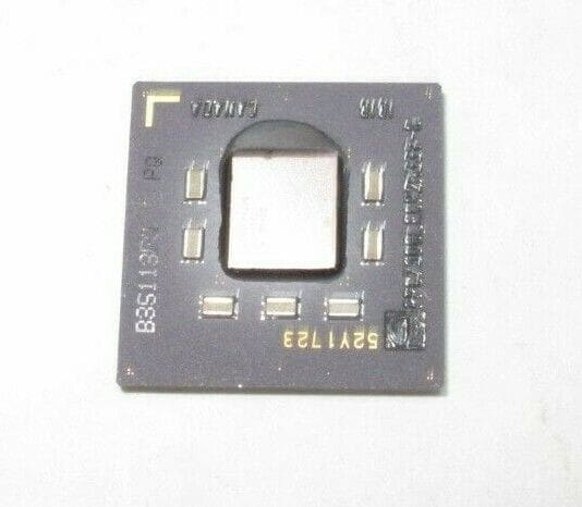

I think either would probably work. You can try searching for PVR values in the firmware to maybe tell which are supported or blocked as described by joevt. It appears that the ZIF models can use 750F or 750G without modification, and these may be closely related to the iMac?
Okay, it's a good experiment to run, but the 750FX's BGA pattern would be different from the G3 installed in an iMac; that has a 360 BGA like a G4 PPC7400.

But I'm still wondering about the BGA pattern of both. A PPC750FX doesn't seem compatible with the pattern of a G3 on an iMac Tray or Pismo; that BGA pattern is similar to that of the MPC7400.
