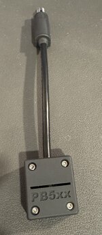

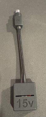

OK, I was reluctant because I wasn't sure it'd like 15V but it seems people are doing it regardless, so might as well make it without extra wires…
Still a few tweaks to make assembly easier but it works.
I really want to confirm from schematics/PCB, but at least testing with AAUI+VGA output, HDD, full brightness, starting Netscape and using the floppy works OK.
