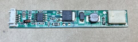

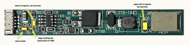

hey team, i was unsatisfied with the reverse signal and just could not let go. So i spent a while really digging though the DF6113 and figured out this mod. I have already used this in several powerbooks that had the "inverted output" problem, and so far it works great. I am not smart enough to explain it... i just kept pushing around data sheet, dismantled a couple controller boards, used google translate to dig through a russian guy's website, and then just started pulling off caps and bodging parts around. This mod is purely to the board, no other wiring tricks or anything (i have tried it with the blue boards, too, the components have different IDs but their location is almost identical).
here is the mod i devised. I tried to show it off in the little movie, but the iPhone adjusts too fast & well, so the movie is pretty much useless.
Pass with your best violence.
