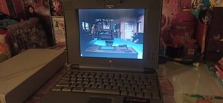

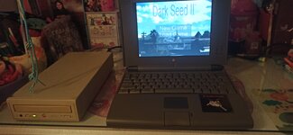

Greetings again.
After two years I decided again to pick up my PowerBook 540c from the basement. I tried again the external 4x apple scsi cd rom with the same above results. But today it seems that i solved my problem. I searched my basement for cables and adapters and i found another one scsi cable like the above. Well, almost the same. It's shorter and it's apple cable, not a general scsi cable like the above. Tested with success Dark Seed 2.
