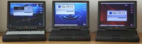

All three PowerBooks (PB 3400c + PB G3 "Kanga" + PB 3400c) are booting to desktop, the left one still with faulty keyboard connectors.
