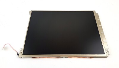

Slight bump, but I impulse bought this LCD panel without realizing the 1400cs uses a different display cable, thinking it looks like a drop-in replacement:
Bezel dimensions might be a tad off, but it does appear to have the right mounting hole locations.
No visible electrolytics either, nor any spaces they could hide as far as I can ascertain.
I might offer it for what I bought it for on the Trading Post, given with the increasing fragility of 90s PowerBooks, I'm not sure I want to keep mine in the long term anyways and probably won't pursue the display swap further.
