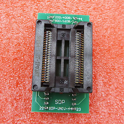

Don't know what you mean there. I'm thinking a set of this type of adapter board pinned to a large carrier DIMM for experimentation:
Thinking a single set of ICs adapted to the board for starters?

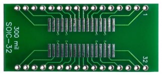

Couldn't find a PSOP44 adapter, but SOIC32 adapter makes for a good example:
Rough estimate puts a pair of them within DIMM's width and each module adapted to your reader/programmer? If not, a quartet of these saves you design time, PCB production cost and pin straightening jig for about $40?
edit: forgot to mention 44pin DIP sockets might be more convenient for installation/removal from carrier DIMM
than widely separated header socket strips . . .
. . . lower profile DIMM Carrier and no PSOP44 soldering involved! 🤪
