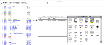

Drivers and patches to support the new hardware. Initially, the System 7 releases were modified directly to include new hardware. But, the System Enablers actually make it more agile (and for us, more obvious what code/resources are needed). For example, I believe making System 6 run on a Color Classic is possible, because it is based on the supported Classic II / LC II and the Color Classic has an enabler where we could grab the specific changes.
For example, here the Color Classic enabler has the same DRVR resource ID/name as the one in the System file, but with a different size as it has been enhanced for the new hardware. Early in the boot process, the System selects and opens the resource file for the correct enabler. Any later code that opens the ".AppleSoundInput" driver will access the Color Classic version instead of the base System version because the enabler appears before the system in the resource chain. Same thing with alerts and icons, etc. (Some resources are additive, not just overlays).
Because the System file is not physically modified, you can boot this same disk on a different computer where a different enabler is chosen (or none at all) and it will work fine. Great for IT as they just roll out one System image for all of their machines. At some point (say System 7.5), when everything has proven stable out in the field and the combined driver works on all computers, they can copy that into the System file itself.

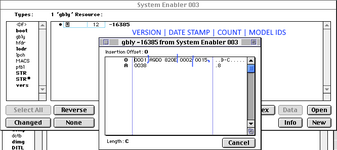

Here is my preliminary research on System Enablers so far. This is subject to change as I haven’t had the chance to step through the code, and Macsbug isn’t loaded until after most of this stuff happens.
1. In Apple Engineering, System Enablers were called “gibbly” or “gibblies” (hard g) because the words “extension” and “addition” were already in use. See “Be Our Guest” Develop issue 14. So, when searching code and resources, you need to use the engineer’s term to find anything.
2. Each System Enabler file is of file type ‘gbly’. Guess why? And, within each System Enabler is also a resource of type ‘gbly’ id -16385. The resource starts with a structure version number, then a date-time in Mac seconds format, followed by a count of supported machines, and followed by the BoxFlag id number of each machine that this System Enabler supports. The example below is from System Enabler 003 v1.1. It is structure version 1, internally built on April 12, 1994 at 4:51.26 ($A9D0820E), and supports 2 machines: LC III ($15=21) and LC III+ ($38=56)

a) Check the System file ‘gbly’ resource for a computer id match. If so, remember this and the date stamp. Because of the date stamp, a newer system enabler can override the system for machines which the system already supports. For example, you could make a System Enabler for an SE/30, which is already supported by System 7.1, and put SE/30 improvements in there.
