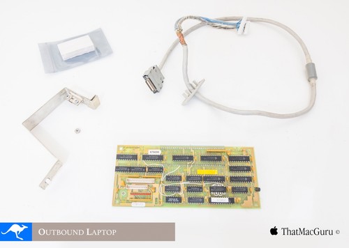

For all searching a harddisk https://www.ebay.com/itm/276054451002 might be an option. Even if it is only 20MB I know with adapters and/or maybe custom made cable it can be used inside a outbound laptop. But you would have to be able to boot your outbound without harddisk.
As also the floppy was discussed inside this thread. It is possible to use gotek drive (at least as internal drive) and boot the Outbound laptop. Slow but it works. Have not checked if it might be possible to optimize something. With the right cable also a standard floppy is working. As far as I remember I used a drive modified to be working inside an Amiga.
View attachment 61541View attachment 61542View attachment 61543View attachment 61544
You still need the Outbound floppy controller board, since that's where the floppy controller chips live. But it works with both the internal and external floppy boards.Just to be clear, you connected the Outbound Floppy circuit board in between the Outbound and the gotek floppy drive?
Thank you. So that's a proof that a standard PC floppy will work with the Outbound, as long as the Outbound Floppy Controller Board is present? Suggesting these Citizen W1D floppy drives should also work if connected?You still need the Outbound floppy controller board, since that's where the floppy controller chips live. But it works with both the internal and external floppy boards.
I'm not entirely sure about compatibility with all standard PC drives, I haven't done much testing there. I've heard others have tried standard PC drives, some worked and some didn't. I don't really have enough variety of 3.5" drives around to test it.Thank you. So that's a proof that a standard PC floppy will work with the Outbound, as long as the Outbound Floppy Controller Board is present? Suggesting these Citizen W1D floppy drives should also work if connected?
