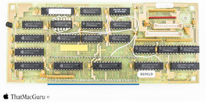

Photos of the Outbound host card for the Mac Plus.
Just a note on the Plus card and cable: As the user I believe outlines, there is a large pad adhered to the underside of the metal chassis. Pretty clear it is good to have. I will get pic. That plus is set aside and I use another for testing. When I connected the cable the board came off the CPU. So that bad is both to prevent it coming off form regular use but also must put pressure on it to keep it on during install.
