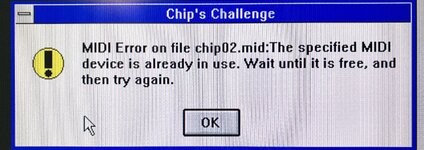

Running into another sound issue in Win 3.1, this time it’s with Chip’s Challenge in the Best of Entertainment Pack:

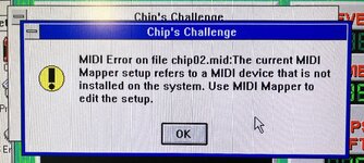

When I open MIDI Mapper in the Win 3.1 Control Panel, I get this error in Chip’s Challenge:
Not sure what is going on here. I really don’t want to mess with the MIDI settings and create more havoc. Here’s what the Mapper looks like at the moment:
Thoughts?
What’s your sound card, I’d reinstall the Windows 3.1 drivers for it. Adlib it isn’t!
Used the install.exe file in the SB16 folder to reinstall the SB-2770 drivers in Win 3.1. All is good now:

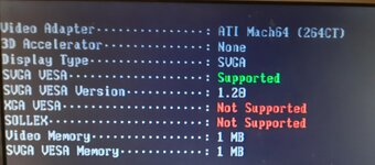

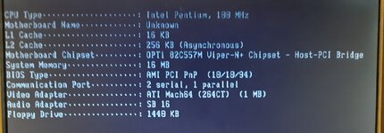

That's what Aida16 shows on the summary and video/graphic pages for the Apple 12" PCI DOS compatibility card:
