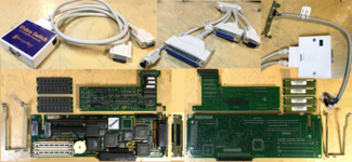

Found the peripheral kit for the 386 card here
Seller is asking $89.99 (which I'm guessing is in US dollars). Seems tempting, although there appears to be no way of contacting the seller (besides joining their mailing list) and I'm unsure if this peripheral kit is compatible with my 486 card. The ad makes reference to a floppy disk drive controller chip, but I do not see the cable for the Apple 5.25" drive.
Is this too good to be true? What say you, 68K brethren?

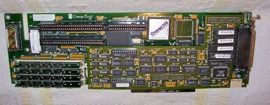

This kit would suit the original Orange386, which had two ISA slots (one 16-bit, one 8) and an additional socket for the disk controller (accessed via the octopus breakout cable.)
I still have not found confirmation on what your model of card is called. It's 386-based (though some of the late 386-based chips used '486' branding) and it's a later, faster model which may have been sold as "OrangePC 200" alongside the higher spec 486 boards, or it may have assumed the Orange386 name from the prior card. I think the ports on the back are DB25 parallel and a serial DIN connector.
I have 2 of those cards, I think they are 386 S/X chips. Anyway, there are 2 sockets one for the floppy controller and one for something else and I think mine each have one chip installed.
Using the ISA expansion slots pretty much means giving up the Nubus slots next to it so I never rigged anything up in mine. The cards work well enough with the Macs built in video. Mine came with no cables as most get lost or trashed.

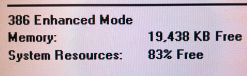

One thing I've noticed is the amount of hard disk space that has been utilized after installing DOS, Win 3.1, the Sound Blaster software and WordPerfect Presentations. I created a 50MB partition for OrangePC on the IIfx's 230MB hard drive, which I figured would be more than adequate. However, according to File Manager, I only have 11.8MB of storage available. Oddly, the memory figures are different when I open an application and check its properties. Maybe I'm misinterpreting something?
Hang aren't you comparing disk free space with free memory? Anyhow looks like a great setup. Really love these cards, the Covox sound thing I'm using for sound in mine is super low fi but fine for MOD playback and basic game sound.
What I'm attempting to figure out is why File Manager in Win 3.1 states I only have 11.8MB of memory left in my 50MB OrangePC partition. I only have 4 programs installed - DOS 6.1, Win 3.1, WP Presentations 2.0, and Sound Blaster 16 software for the SB-2770. I doubt those 4 programs are consuming nearly 40MB of memory in my 50MB partition. What is equally odd is the value of memory available increases to 19.4MB when I open an application (i.e., "Solitaire"). Could one of these figures pertain to the 10MB of RAM that is installed on the OrangePC card?

You're confusing hard disk space with memory (RAM). Two different things. The 19,438KB free is how much RAM (physical + VM), analogous to what you are shown on a Mac under About This Macintosh.... The File Manager value of 11.8MB would be the correct value for free disk space.
EDIT: But I agree, 38.2MB seems like a lot of disk space for just that stuff. I'm guessing the difference is being taken up by the Windows 3.1 VM swap file.
Not intentional of course. I wasn't sure what the 19,438KB value was referring to (although I figured RAM was involved somehow) but you've clarified that so thanks.
I'll look into disabling virtual memory and see if it frees up some disk space in my partition. Interesting tidbit - my Win 3.1 software box states I need (at the minimum) an HD with 6MB of storage available to install the whole OS (10MB recommended).
