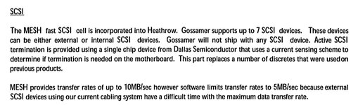

    Heathrow in Gossamer:
    MESH provides transfer rates of up to 10MB/sec however software limits transfer rates to 5MB/sec because external SCSI devices using our current cabling system have a difficult time with the maximum data transfer rate.
    How does software change MESH in Gossamer from 10 MB/s to 5 MB/s?

    I don’t know about others but I do know the Linux kernel features a setting to govern how fast MESH transfers go.
  • DBJ314 —
    2026-05-18, 3:11 PM
    It looks like the SyncPeriod field within SyncParms register. The SyncPeriod field contains the period of the Req or Ack pulse when the MESH controller is in synchronous data transfer mode. The value must be adjusted to match the SyncPeriod time agreement in the SDTR messages. Although the ANSI SCSI specification allows resolution down to 4 ns, the driving software must negotiate a period that is acceptable to both the controller and the target device. A value of 0 indicates 10 MB per second, and 3 indicates 5 MB per second. The equation for determining the period of the synchronous Ack signal is (4*clk + 2*clk*SyncPer) where clk represents one MESH Clk period and SyncPer is the value in the lower nybble of the SyncParms register. Fast synchronous operation is a special case, where 0 means 100 ns.

    DingusPPC does have some SDTR code, but it doesn't parse any of the info. linux/drivers/scsi/mesh.c has a add_sdtr_msg function where the third byte is set to mesh_sync_period/4 Would be nice for DingusPPC to log the SDTR info so we can see if Gossamer is set to 10 MB/s or 5 MB/s.
