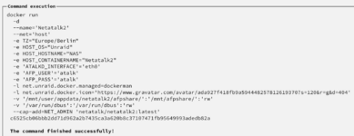

Maybe some of you experts can help me getting the docker container running un UNRAID? That would be really, really great.
Here is the startup command. Besides the important environment variables, there are some UNRAID-specific ones which can be safely ignored.

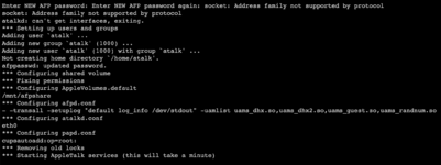

But the container does not start up successfully. Here is the log:
From what I have read, the famous
Code:
Address family not supported by protocol
messages indicates the host kernel does not support DDP. Correct?
The reason I'm asking is because @ironborn65 managed to get the docker container running on his Synology, and the Synology kernel seems to have no DDP support either.
Any idea what I did wrong?

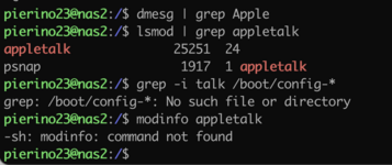

Does synology store the linux kernel in the same place as regular linux distros? If so, if you can get onto the terminal there's two ways to check if appletalk is compiled into the kernel or not.
1. Run grep TALK /boot/config* it might yield something like this:
Code:
$ grep -i talk /boot/config-*
/boot/config-5.13.0-39-generic:CONFIG_ATALK=m
/boot/config-5.13.0-39-generic:CONFIG_DEV_APPLETALK=m
2. Run modinfo appletalk and see if it gives you any information
This is exactly the information Synology gave to me as well, and therefore I assumed the Synology kernel would not support DDP.
AppleTalk support in kernel has nothing to do with what version of Netatalk the vendor chose to use. You have actually query the kernel for its capabilities like @davewongillies describes.

pierino23@nas2:/$ uname -srm
Linux 4.4.180+ x86_64
for Synology DSM 7.1.1-42962 Update 6
dont' ask me what it means :)
