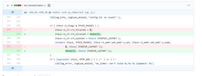

I had found a post somewhere (maybe Google groups?) where somebody had noted the issue with 2.2.6 related to two lines of code and by rolling back to the red lines in main.c it would properly work again. (My notes from that indicate otherwise it would note something about the address range being too large).
Does this Netatalk 2.2.7 have any other changes besides the below?
@superjer2000 Yes, this was the first patch that I got merged to upstream Netatalk 2.2 back in November of 2021. It fixes routerless AppleTalk (which is what you usually have with a single zone AppleTalk network) on Linux, which was broken when fixing the same for NetBSD. Later on, NetBSD compatibility was restored with this patch.
