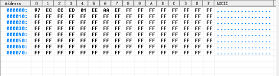

U6 is an AT93C46. 1024bit EEPROM
Pulled it off my board and read it. it's fairly empty...
Reseated it and re-read it multiple times. This seems to be all that's on the thing.
Wow, that's baffling, but definitely helpful, and probably an important thing we were missing. Thanks @finkmac! I have no idea what purpose those 8 bytes serve, but they must be necessary, otherwise the part wouldn't be there. I have some 93C46s on the way.

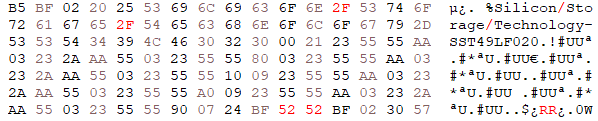

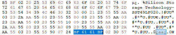

So, the device code check...that should be pretty easy to hack, right? Here's how it's encoded in the firmware:
The manufacturer code and device code are in there twice, the second time is endian-swapped, no idea why, but all the ROM entries are like that. So, a simple change to BF 52 52 BF should do it, but that'll screw up the checksum, right? To take care of that, I used the old trick of adding some bits elsewhere equal to what I subtracted. In this case, 0x61 - 0x52 = 0xF, so I needed to add 0xF in two places. I chose the spaces before and after Storage, which turns them into ASCII slashes:
I was feeling quite clever, but this did not work. Thanks to the detokenized Forth that joevt posted earlier, I was able to figure out where the checksum is stored and how to calculate it, so I made another version of the ROM where instead of adding 0xFs, I corrected the checksum. That didn't work either. With either modified ROM loaded onto the SST49LF020A, connected devices will show up in the boot menu when holding down the Option key, but I cannot boot from them, and they do not show up when booted into 10.4 on another device (and neither does the card).
If I load my modified ROM onto the W49V002AP and install that onto either card, it works fine, so I don't think I screwed anything up. Something is still weird with the SST49LF020A vs. SST49LF020. The only difference I can find in the A version is some ID pins that are used as straps, so that up to 16 of the devices to share the same bus. I'll look at what, if anything, either card is doing with those pins. In the meantime, I have some W49V002APs on the way.
