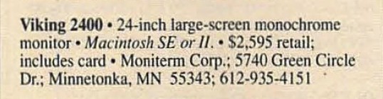

Moniterm made monitors advertised for desktop publishing in the lat 80's - early 90's with the Viking brand.
I found this in the Spring 1990 edition of Macintosh Buyers Guide.
So that would appear to be the card that came with that monitor.
Interesting - Minnetonka is only about 15 minutes away from me! Might have to go check out the address...
