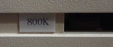

Two other stickers on the front of the case caught my eye.
The 800K sticker suggests that this Macintosh II also has the newer ROMs and SWIM, as the sticker came with the 1440K floppy drive upgrade.

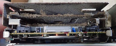

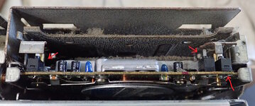

Indeed. Here is the 800K drive, with two detection switches.
And the 1440K upgrade on the right, with three detection switches. Neither drive works, as they need serious cleaning and relubrication.

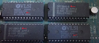

Of course, the ROMs have been upgraded. I was initially confused by the letter 'B' and the letter 'C' on the ROMs. I thought maybe only half of the ROMs were upgraded. But, the '342-0639' through '342-0642' portion of the part number is the important indicator. I believe the 'B' and 'C' are just vendor codes for the PROM. Anyway, the point is, when you look up your Macintosh II ROM codes on the internet, don't worry about the final letter.

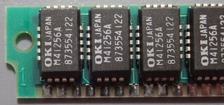

I wonder how much system memory this Mac has? It must be chock full. Hmm. These look suspiciously like 256K SIMMs.
Short-height SIMMs with 18-pin PLCC with pins on all four sides are almost always 256K. The part number confirms it.
For all of its upgrades, this Macintosh only has 2MB of RAM. The RAM date code is the 35th week of 1987. All the other part numbers on the computer are six months to nearly a year later. I doubt Apple's supply chain would have memory SIMMs sitting around for a year. I suspect that the original memory was swapped out at some point.

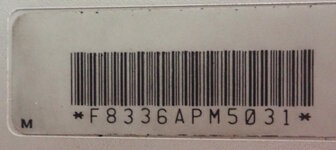

"Your (M5031), with serial number F8336APM5031, was the 7299th manufactured during the 33d week (August 15) of 1988 in Fremont, CA." Most of my Macintosh II computers have a M5000 ending. Is M5031 an A/UX configuration?

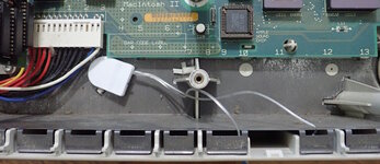

That brings us to the final auction mystery. In the posted images, there was a small white object with wires connected to the metal shielding of the case. Was it an alarm installed by the university to alert them when someone opened the computer????
Ha. Nothing is ever that dramatic. It's a lame C2032 coin cell holder that replaced the clipped battery. It must have fallen off at some point.
