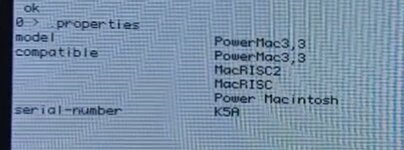

Sorry if the question seem stupid but how can I check in OF that the MacRISC2 descriptor is present or not ?as per the OP make sure your machines firmware is fully up to date, it was only in later BootROM's did apple add the MacRISC2 descriptor which is what the modified ROM looks for instead of "PowerMac3,1" etc
Thank you !!!Just type...
dev / .properties
I think. I'll go and check.
Edit - yeah. This is mine :
