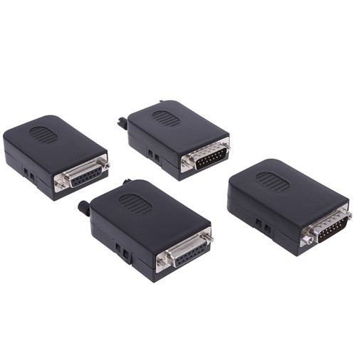

One of these might be a nicer way of doing it.

For sure if you have a DB15 breakout, it's a bit more convenient, but sticking wires into the holes also works. :p
Surely we all have a pile of those, with different pin counts and genders, in a box? They even do HDMI ones :p
How else do you plan to connect your home brewery system to your Centris 650's National Instruments NB-MIO-16X?
