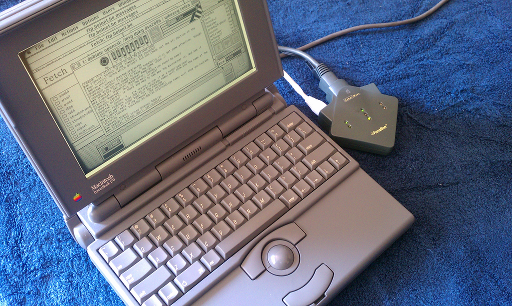

It does work with FTP, WWW, whatever you like TCP/IP protocol without the MacIP bridge. This PowerBook 170 was connected directly to the Internet via the Ethernet cable out of the EtherWave.

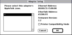

The setup utility lets you pick which zone you're on, so I'm assuming there are some smarts in there for something. Getting this utility working with a MAC address ending with 00:00 was...interesting. It would complain that the adapter is not serialized and to contact Farallon for help, but I cheated and patched out the serialization check in the setup utility. (BTW, it's kind of funny that printer compatibility mode was off by default on my EtherWave Printer Adapter... :))
