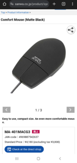

Interesting thread, I've been searching for a 2 buttons mouse for some time and some really are one button mouse with 2 buttons.
For example this one I got not long ago, the Sanwa Supply small confort mouse MA-402MACMD
The product webpage show this
If I look at another model from the same brand and its specs, you'll see the difference in the compatibility info at the bottom.

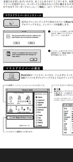

The control panel looks like this:
It's downloadable at
