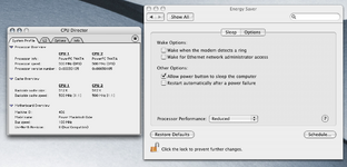

The version of CHUD that I have won't enable NAP mode on dual CPUs for some reason, so in this situation the CPUs always need fan cooling. However, CPU Director will enable both NAP and DFS which cuts the idle power to almost nothing. With DFS enabled, even under full load the dual 1GHz 7447 (at 500MHz w/DFS) uses less power than the stock 450MHz CPU. I think I'll call the experiment complete.
What version of Mac OS X are you running? I think CPU Director doesn't work on anything later than Mac OS X 10.4.9 but at least CHUD can be used to verify the CPU settings.

I've been playing some more and I think the dual 7447 would be safe on the stock Cube VRM at 1GHz. At this setting it uses less peak power than a dual 500MHz 7400 from a Gigabit Ethernet tower, and these CPUs have long been a popular upgrade for the Cube (using the stock VRM).
very interesting, from reading of linux src comments ("/* 32 bits SMP can't NAP */" from linux-2.6/arch/powerpc/platforms/powermac/smp.c) I thought it was impossible!
Any way to track what exactly CPU director does?
