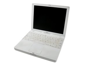

Hello! I got an iBook Clamshell from my local hackerspace and was trying to fix it.
The display had the vinegar syndrome, so at first I thought it just had a bad display, but after some time I realized that it wasn’t giving the startup chime at all.
The HDD spins (I swapped it to an IDE to SD card reader, so I can’t hear it anymore), it does get power from the power adapter. However, I don’t get the chime, no composite video, no nothing. I also tried different keyboard combinations for resetting PMU/PRAM to no avail.

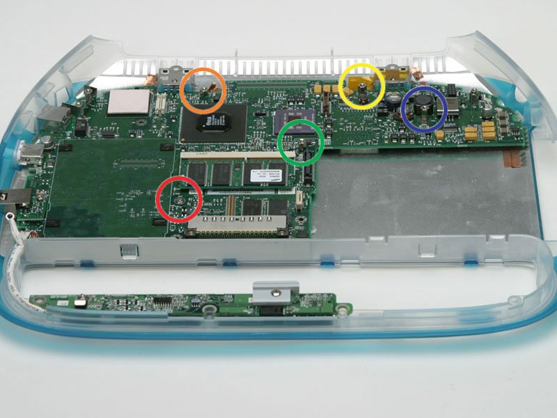

I tried checking the logic board and it seems okay. No leakage from the supercapacitor.

I notice you are testing the logic board with it resting on the metal bottom of the keyboard. Are you sure that this is not causing a short circuit?
You could clean this logic board with distilled water and a soft brush. 90% Isopropyl alcohol would work too. Just make sure to let everything dry well.
I removed the metal bottom of the keyboard, so I'm not causing any shorts, but that still doesn't let the board boot.

I dont exactly know if there are areas/components on the board that actually need to be grounded, meaning it needs to sit in the chassis to work properly.

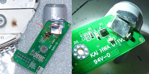

- I would clean the board with IPA and a soft toothbrush and let it dry well.
- check if diode D1 on the small powerboard was shorted and is blown ( due to the stupid aluminium foil on the socket)

I cleaned it up as recommended and checked the D1 diode. It looks okay, no shorts. Just in case I put it back on the shield, after a few boot attempts the HDD spins. It’s interesting that the HDD not just spins, but the head moves as well, as if it’s reading something from disk.
