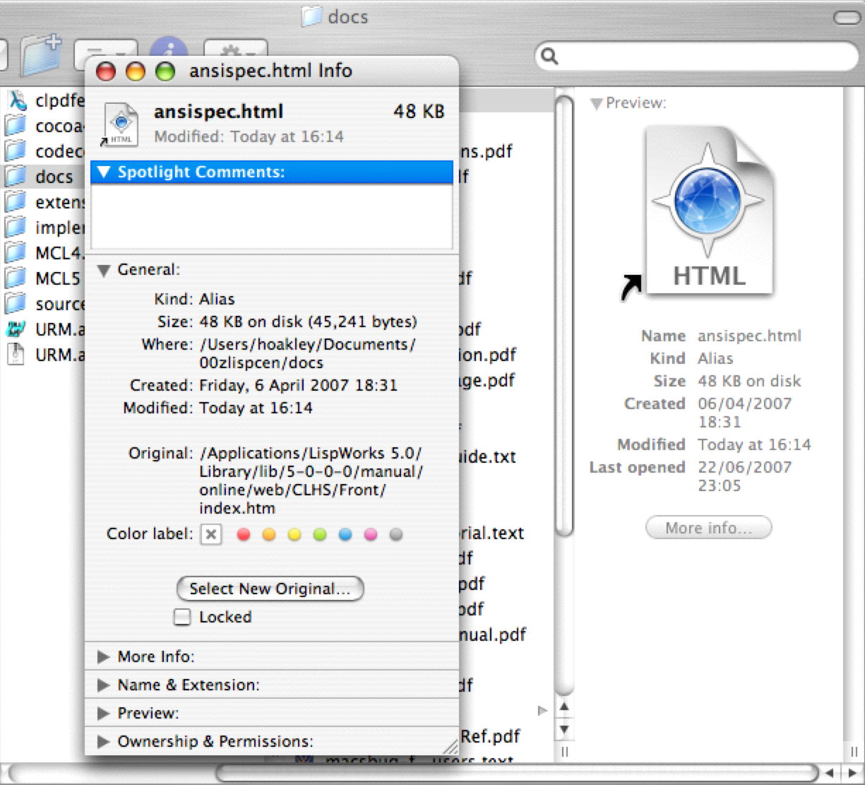

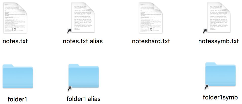

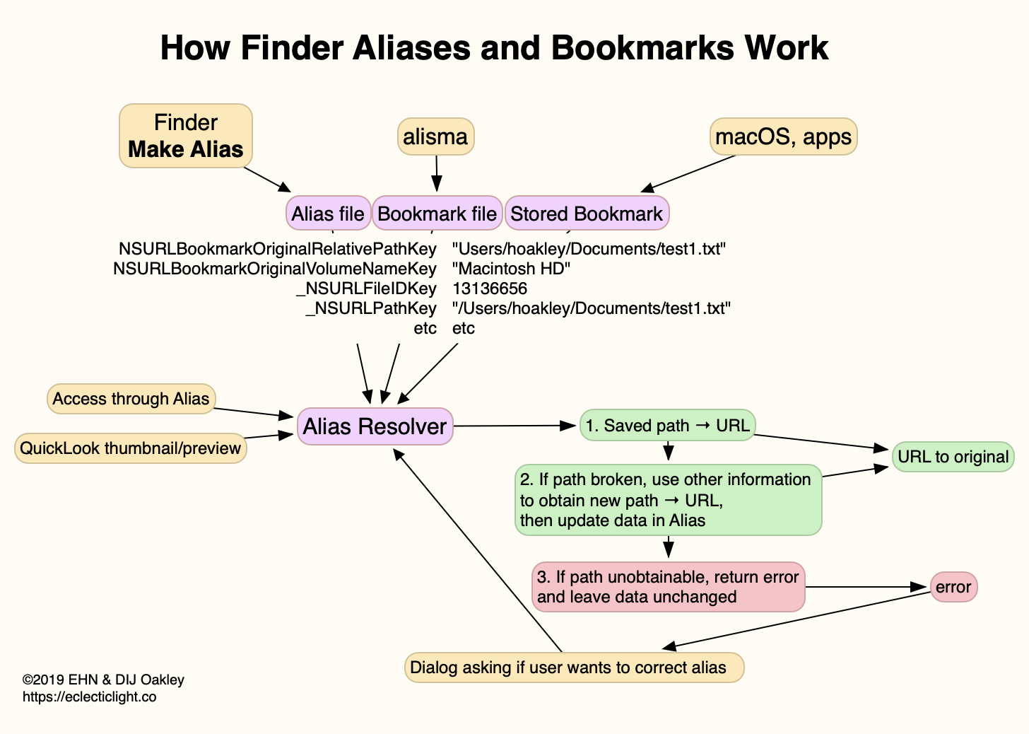

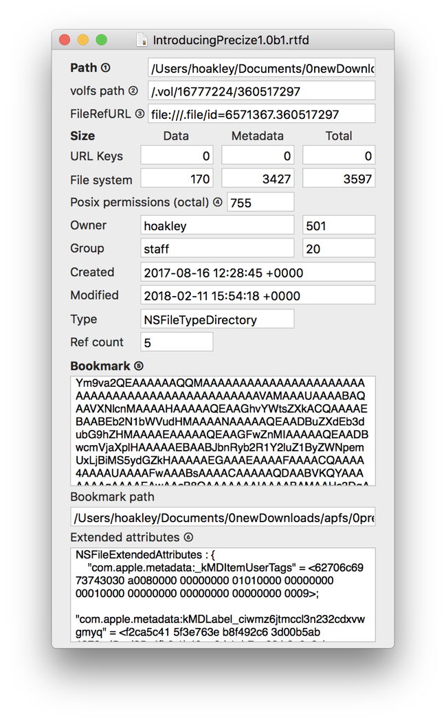

I need, in the future, to keep track of a few directories, and I've read somewhere that we do that by creating aliases. I have no idea how that works, but I imagine an alias will keep a reference to the directory in disc? As long as I can retrieve it, I think it will be safe even if it WD number changes.
Volume reference numbers and working directory reference numbers and file reference numbers can all change. They all depend on when they were opened.
32-bit Directory ID doesn't change. Similar to file inode numbers.
There's a 64 bit HFS Volume ID per partition which should be unique. I don't recall a simple API to get this.
Volume name can be changed by the user but it's better than nothing.
An alias stores a bunch of different info: path, directory ID, network share address, etc. An alias can be rather large. They might be overkill. Maybe just use a path or a volume name + directory ID. Add directory name if you want to notify the user when a directory name changes.
