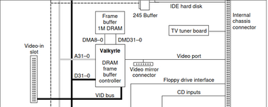

Where does that overlay function reside if not on the Valkyrie chip?The Valkyrie chip isn't drawing the output from the TV tuner card at all. The video is being painted onto the Valkyrie's display by a nifty overlay function. Think of it as two screens, the Valkyrie frame buffer with your desktop, and a black screen with just the video output, perfectly sized to match the window on the video player. The video display is mixed with the Valkyrie output and sent to the RAMDAC. Its how countless ISA TV tuner and MPEG decoder cards worked and gets around the bandwidth limitations inherit in early computer systems.
This is why taking a Cmd-Shift-3 screenshot of the video never works. You get a black box (or pink which is a common key color on Windows) in your saved screen shot where the video appears on the screen. You can even see this in action you you drag the video window to another place on the screen. For a split second, the video is still in the old location before it starts drawing at the new location. Most TV tuner viewers have a dedicated snapshot function if you want to save a frame of video to disk.
IIRC, that makes all the sense in the world. Video screenshot was how I was able to cut and paste VidCap window contents into the blank window of the CMD-Shift-3 VRAM screenshot.This is why taking a Cmd-Shift-3 screenshot of the video never works. You get a black box (or pink which is a common key color on Windows) in your saved screen shot where the video appears on the screen. You can even see this in action you you drag the video window to another place on the screen. For a split second, the video is still in the old location before it starts drawing at the new location. Most TV tuner viewers have a dedicated snapshot function if you want to save a frame of video to disk.
The overlay function mixes the output of the video data frame buffer and the graphics data at the output stage (RAMDAC). They never share memory or otherwise interact with each other. A 68040 based machine can't handle capturing uncompressed full motion video (even at 320x240) over the bus. You need a fairly fast PowerPC machine with a modern bus (PCI, or its native processor bus).The display memory contains three separate frame buffers. The first frame buffer holds
the graphics data—the display that is generated by the computer. The other two frame
buffers hold video data from the video input module. The video data frame buffers are
used alternately: while one is supplying data to be sent to the video monitor, the other is
receiving the next frame of video input.
It’s Picture In Picture, in the analog space, just like a fancy CRT TV from the same era.
