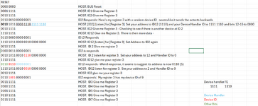

On the input side, some things are happening... I connected my logic analyzer and watched what was happening when the Hootswitch boots up. It seems like the Hootswitch finds the keyboard and the keyboard sees the Hootswitch but the back and forth doesn't seem exactly as I would expect from my limited research on the ADB protocol. I only had one keyboard connected (an Apple Desktop Keyboard (i.e. the one that shipped with the Mac SE) and here's what I'm seeing:
It seems like the Hootswitch and the keyboard go around in circles a bit with respect to registering the keyboard. I need to connect my analyzer to an actual computer and see what it does. After the startup sequence occurs, it doesn't seem that there is any activity on the bus. The Hootswitch doesn't seem to poll and pressing keys on the keyboard doesn't do anything.

Reading a blog post on BMOW it does seem the flipping back and forth of the address ID is normal. So it seems after that happens the Hootswitch just stops doing anything on the bus. Not sure why yet. May need the debugger.
The address shuffle is a good sign, at least some communication is happening.
